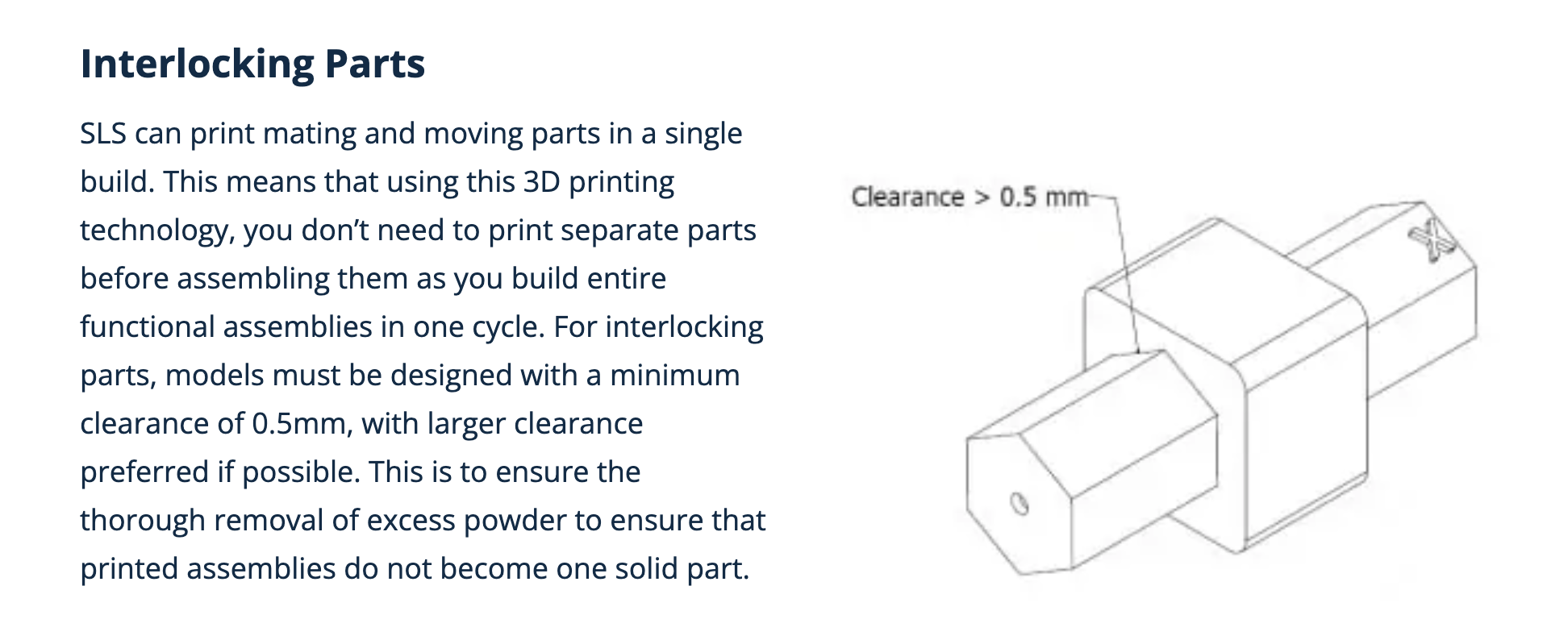

      This is a screenshot of Xometry Pro, where you can find nice design tips for every Tech
      Selective Laser Sintering (SLS) 3D Printing
