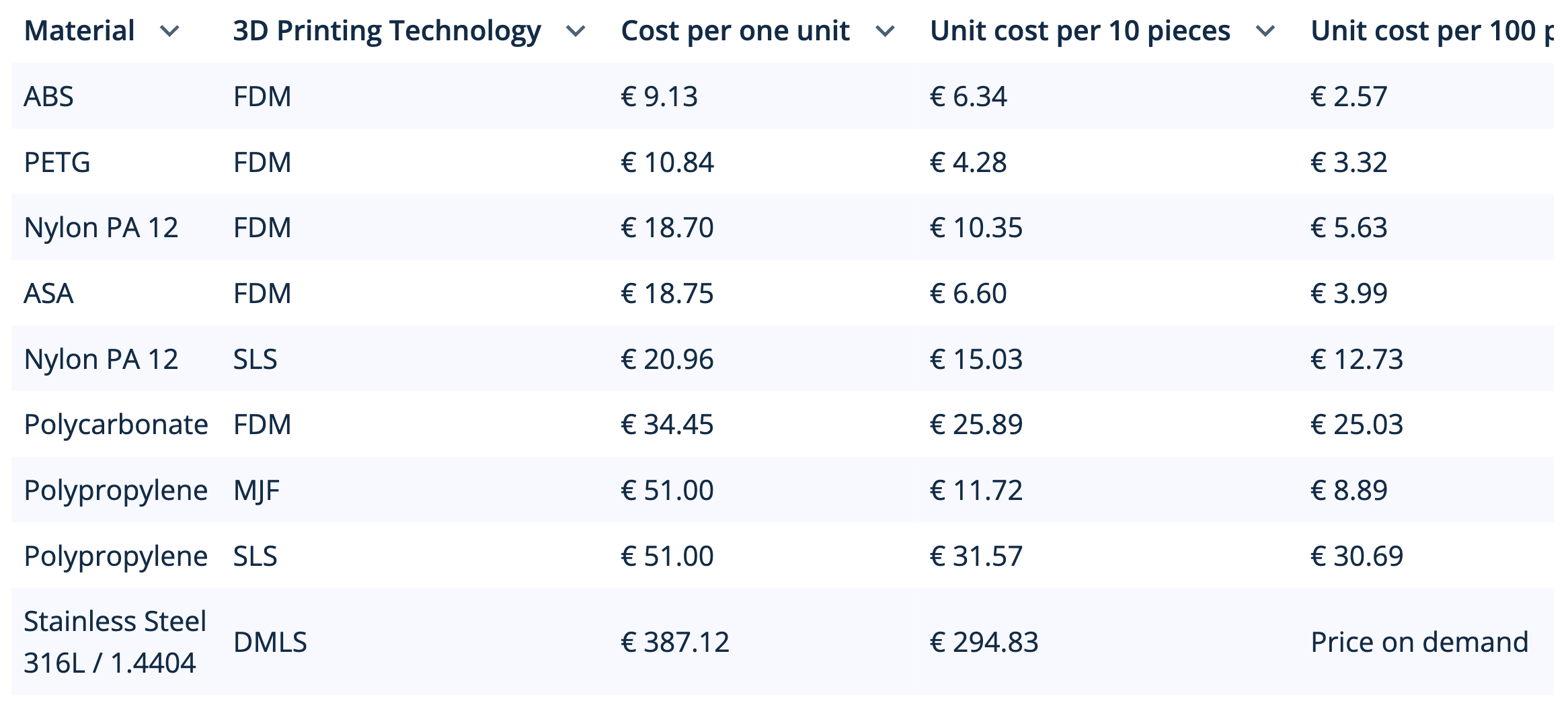

      • Senior Content Manager
        Attila Szucs
        To jump back on Attila’s feedback, I invite you to check out this table below – we compared the prices of several water-resistant materials in our Instant Quoting Engine:
        So, according to this table, PETG remains a good option for your experiment if you don’t want to spend too much money. But actually, I think ABS could be even better, because, as Attila mentioned, it can be vapour smoothed to ensure its waterproofness.
    • Manon Bouriaud
      This price comparison is really helpful, thanks! I hadn’t considered ABS due to concerns about its strength and UV resistance compared to PETG, but vapor smoothing for waterproofing is an interesting point. My only worry is about the potential warping during printing and the fact that ABS might not handle outdoor conditions as well as PETG or PP…
