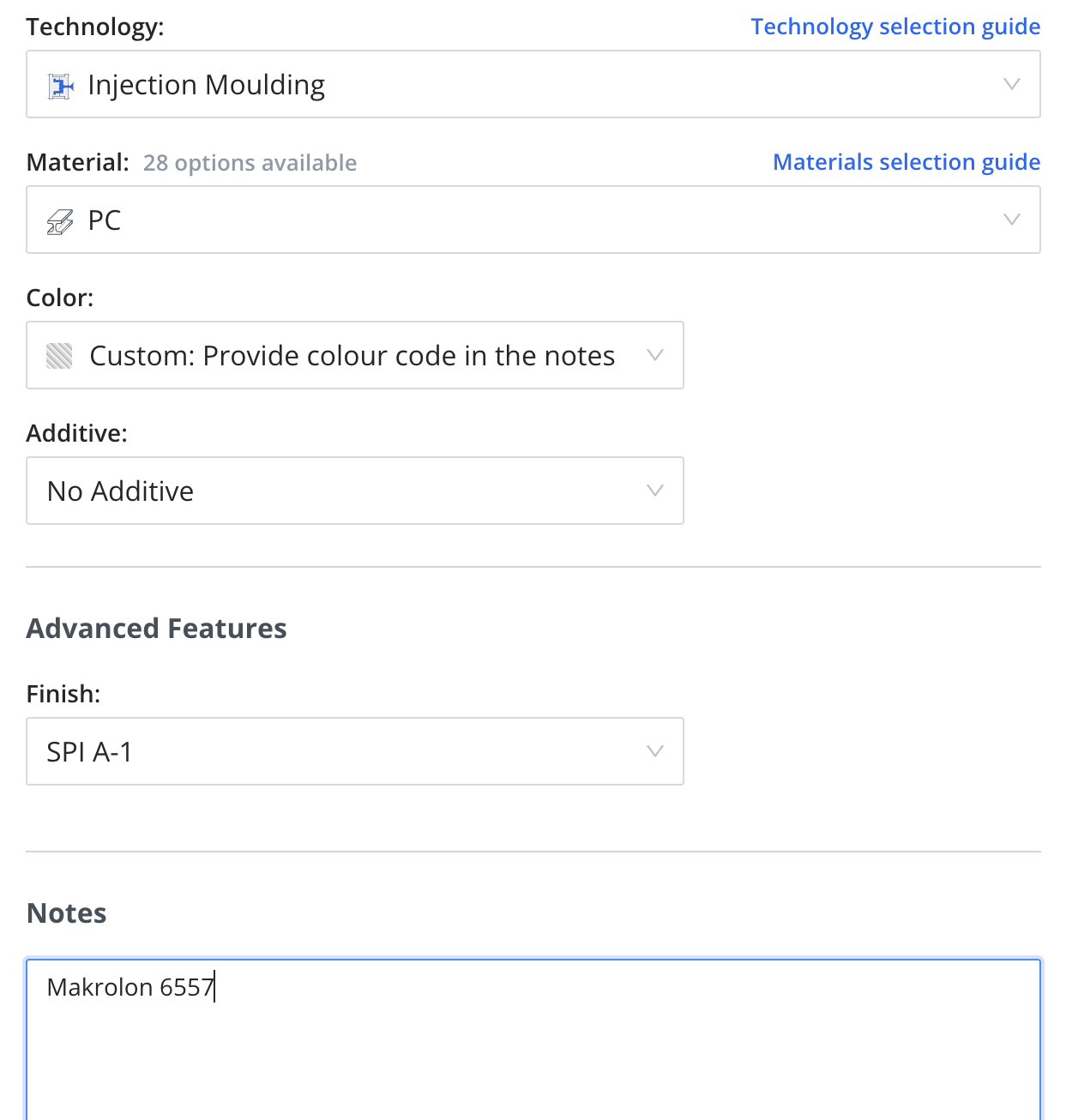

        Hi Anton, Thanks for your prompt reply. Started to proceed with the quote right now. Will that be correct if I choose PC here  and just add the required material you advised in the notes? Also wondering, what finishing option should I choose? Thanks again
      Thank you for your response.
      it looks like you filled out the request form correctly.
      in terms of surface quality
      Unfortunately, we cannot give you a precise recommendation on the finish, as we do not know the application conditions of the part.
      You can check our article on surface finishing, which is quite detailed and also order a die with finishing examples.
      Injection Molding Surface Finishes: SPI and VDI
      In general, if it is a view (transparent/semi-transparent) part, we recommend SPI A1…A2.
      If the transparent/semi-transparent part needs a small grain surfaces, we would recommend SPI D-1 or VDI 21/24/27 depending on your needs.

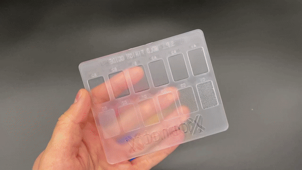

        Actually, we also have a transparent injection moulding card sample. Check it out:
