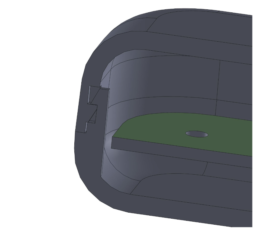

Where do I start? I’ve had a play with some design ideas, but it’s impossible to validate them as our FDM printer really can’t handle either the fine detail or the strength. My snaps didn’t engage much and broke off really easily!
This is what the snaps look like, but they just break off so plz hlp!

      Hey Alex. I hear you. FDM isn’t ideal for this kind of fine detail. I suggest you use SLS for the prototypes, as this gives you high strength and pretty good reproduction in the fine details. The biggest benefit is anisotropic properties, so you can have strength to spare in the snap features. Most suppliers carry PA12 nylon, which is good.
      At first glance, this is quite a stiff box. I assume that’s a 1.6 mm PCB I can see? Helps me to scale the case. If so, I’m not surprised the snaps break, they’re pretty aggressive (which is good) but the upstand is quite short, so you’re asking for a lot of concentrated bending as it snaps.
      There’s some changes I’d suggest to the snap feature, but a bit of context would help us. Q: Do you ever need to open the box?

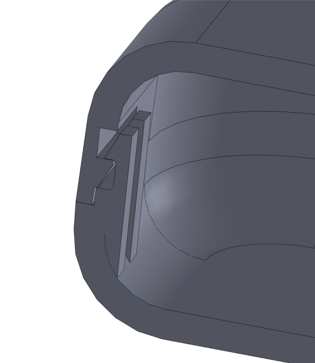

      It’s only a little elephant, we can eat it one bite at a time. How about if your snaps were not one piece, but several legs like a comb? This kills two birds – it will reduce the stiffness AND ease some of the wall thickness issues.
      • A
        DrewK87
        I think this is what you suggested, I like it. I’ve reduced the engagement and ‘weakened’ the snap legs as well.

        I like this, those legs look less stiff. You added filets below the snap so they’re less likely to crack. That’s nice. Did you also reduce the depth of the hook engagement, do I see?
        I suggest you reduce the recess that you’re snapping into. Get it too deep and you’ll see a shadow on the outside, at the thickness change. Also fillets at the bottom of that pocket will blend the walls a bit better.

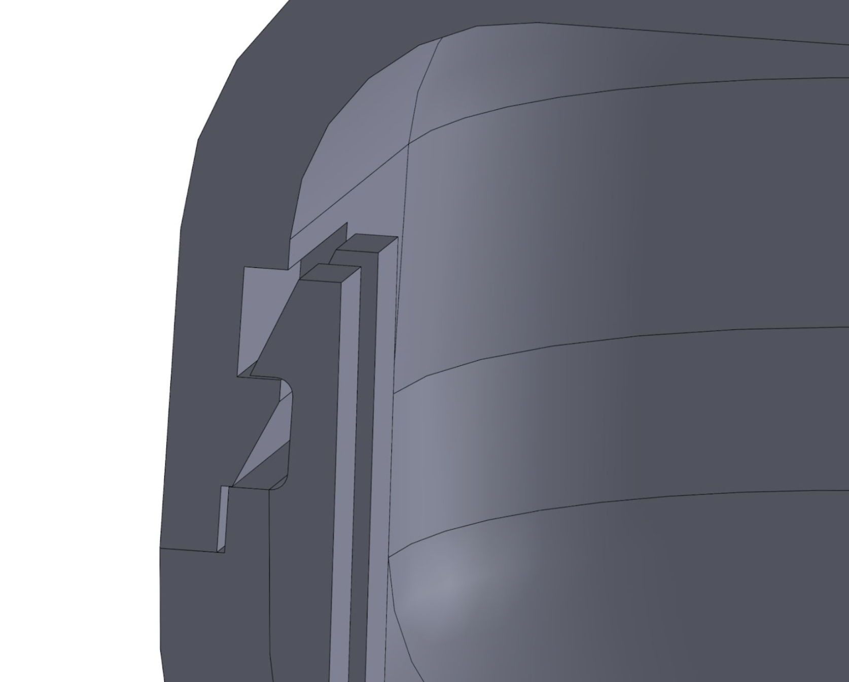

        Hey DrewK87. It is feeling nicer. Yes, the fillet felt right, and I reduced the snap by 25% or so.
        I like your thinking. This is what came out of it. Thanks for your help!
