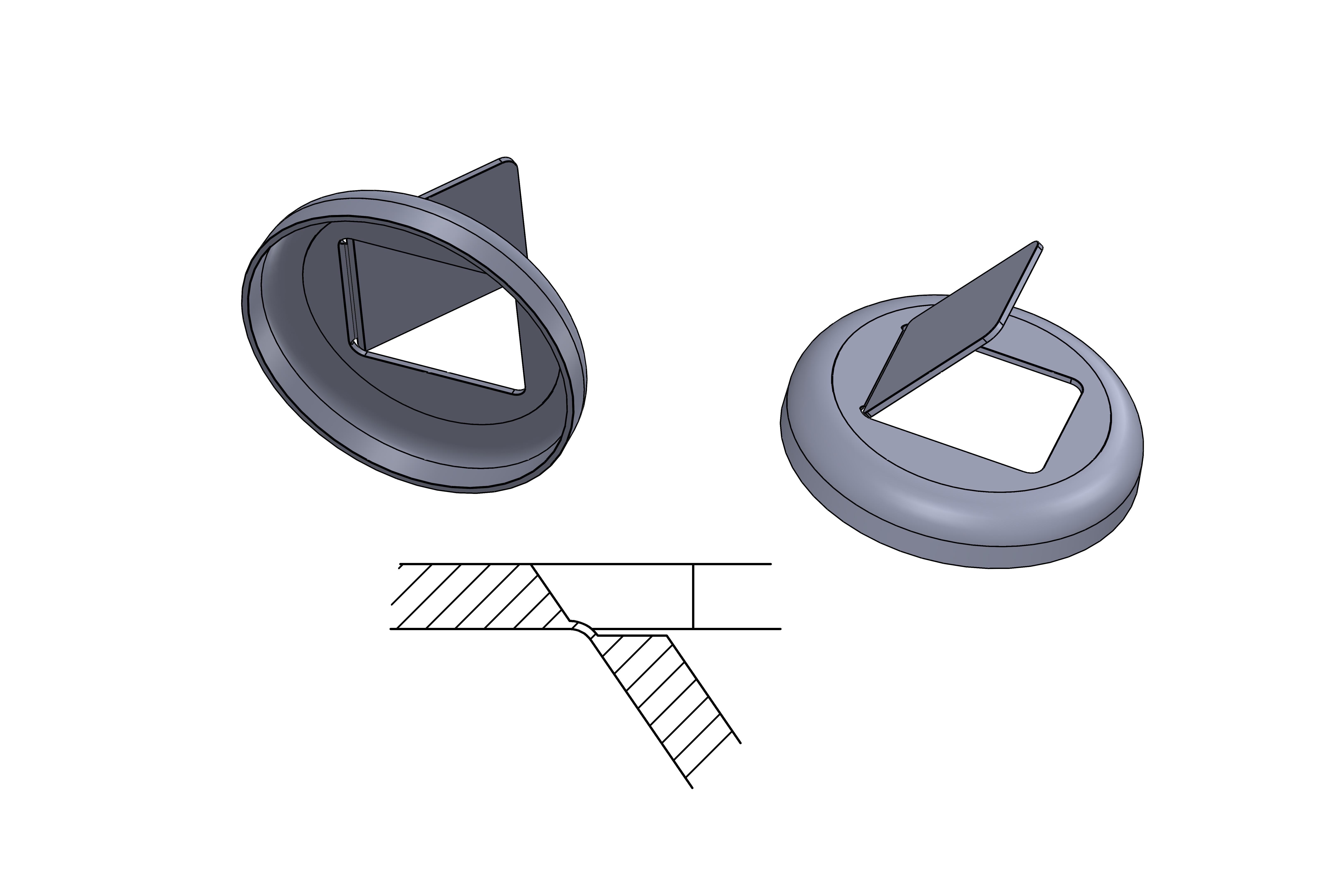

        Good point. He’s the model I created following these design tips. Now I want to make sure the molding process of the live hinges will be flawless.
      • C
        Daniel Harris
        Finite element analysis can help in the design phase. It will tell you about flow. Simulation can prevent mistakes and allow you to tweak the design before tooling. This saves a lot of time and risk, particularly because you can’t trust prototypes. 3D printed and machined parts cannot give the right material properties in the flex area.
      • D
        CommunityMember
        This is really helpful, thank you. I’ll also run flexing tests for the hinge to confirm it can withstand repeated use.
