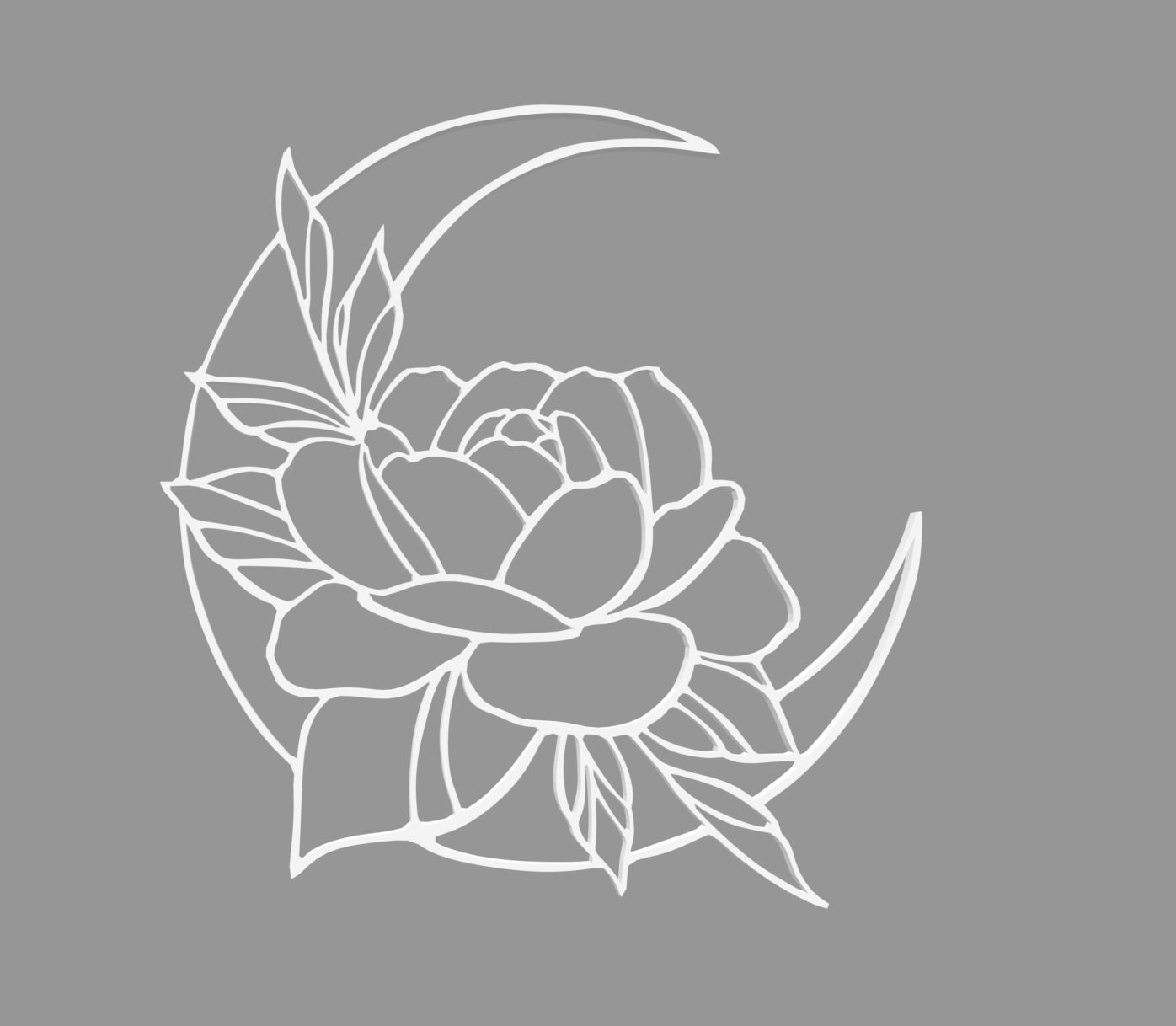

Hello everyone, I would like to produce some slim decorative parts (they are 1.5-2 mm thick) for a musical instrument by means of 3D printing. Attached you will find a screenshot of one of the models for viewing. Could you recommend specific technologies or materials? I want a part that sparkles, reflects, looks metallic. Metal 3D printing looks great, but is a bit too expensive for my needs. Do you have any affordable alternatives or finishing techniques you could recommend? I plan to glue these parts onto the instrument. Thanks in advance!

Have you ever thought about Alumide? It's a variant of Nylon, but with metallic particles. It could be a good solution if you're looking for (relatively) cheaper parts with a metallic look.
Another option is the nickel plating of MJF/SLS parts, which also creates a kind of metallic look.

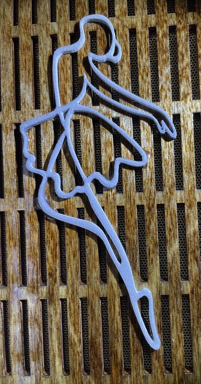

      I got my parts, it really turned out well with Alumide and just the way I wanted it – here is an example.
      Thank you so much!

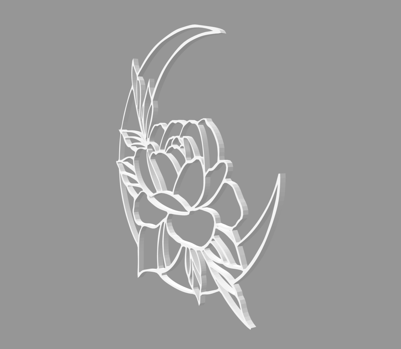

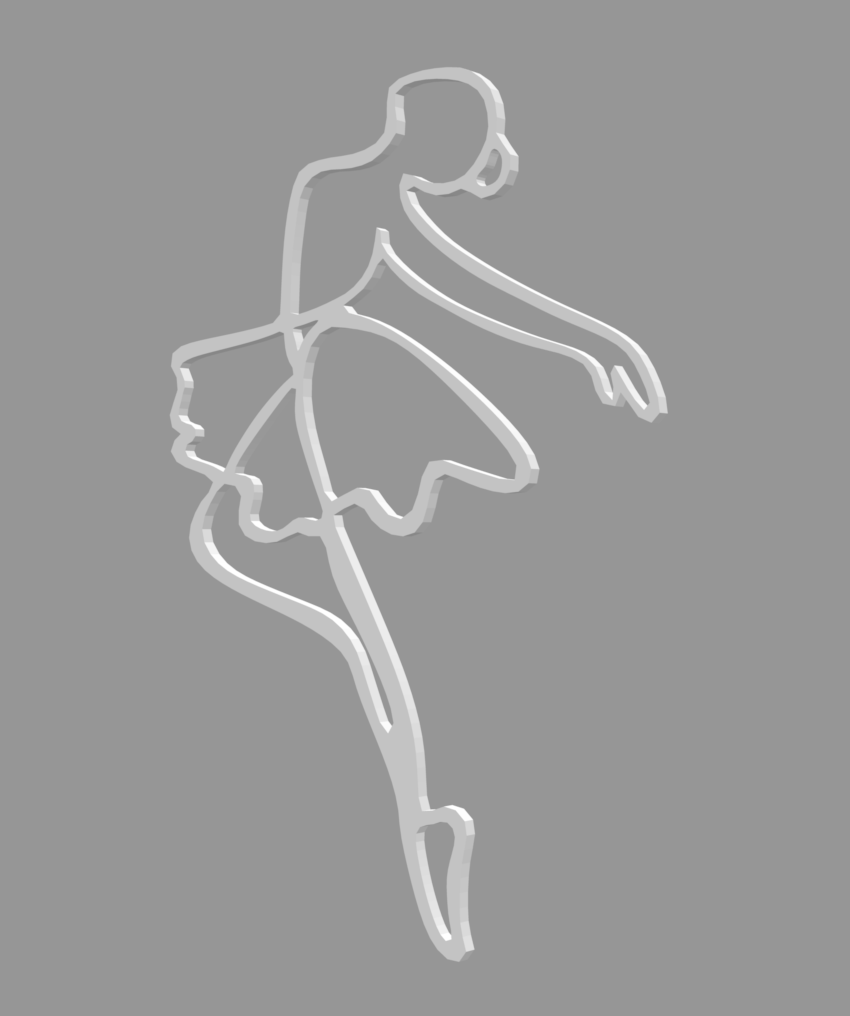

      …and here is the model I had
